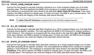

Hi sir,
請問關於data memory ,Configuration [Integrity Data]頁面的 All DF Checksum,Static Chem DF Checksum 與 Static DF Checksum用意為何?
