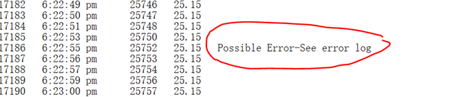

Hello,

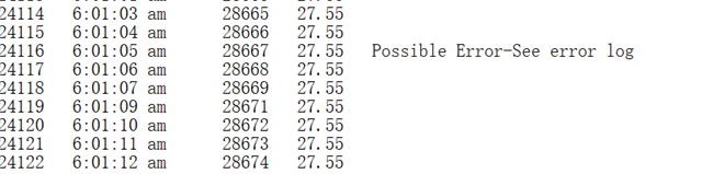

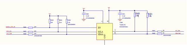

We use BQ20Z95 as battery gas gauge IC. IIC BUS as data interface.
Between MCU and battery, we use TAC9617A as IIC repeater.
We monitor the temperature data of battery by MCU with IIC bus, we find there are some extremely low(-273.05, -272.55) and high(317, 5380.85, 5329.45) temperature data during monitor process, although the rate  less one in a thousand.
Whatever we change pullup resistor value, the extremely temperature always exist.
Could you help analyze why this issue happen and give a hardware solution?
