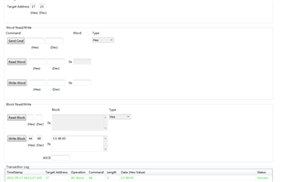

您好, LED chg thresh 5 must be set to 101%. You will not be able to do this with the bqz so it would have to be done manually with a DF write using the advanced comm tab.

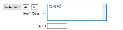

here's how to change it to 101%:
Do a write block with 0x44 as command and the data in the image in the block.

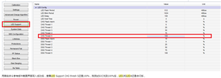

您好,请参考下面内容
With the LEDCHG configured the gauge will try to blink LED5 so the LED4 threshold would need to be set so it doesn't blink until full charge, the final threshold for LED4 should be 100%.
那我CHG thresh 1-5分别如何配置?现在客户要求SOC≤25%亮一个灯;SOC≤50%亮两个灯;SOC≤75%亮三个灯;SOC=100%四个灯全亮;
您好,参数设置参考下面的表格,看一下是否还有led闪烁问题。
| CHG Thresh 1 | 25% |
| CHG Thresh 2 | 50% |
| CHG Thresh 3 | 75% |
| CHG Thresh 4 | 100% |
| CHG Thresh 5 | 101% |
