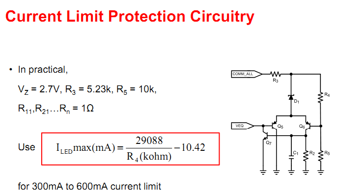

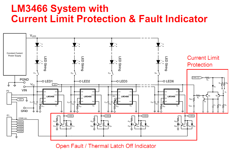

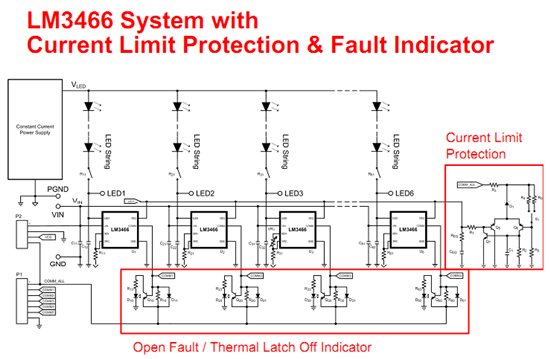

Hi all,
I'm using LM3466 for current balancing, and I try to add the current limitation circuit as below circuit, but now the current limitation function cannot work.
Circuit Diagram 1:
I select the R4 (48K for 600mA) with above equation, but how about the R2 and C1 parts parameter? and how about the R1 resistor in Circuit Diagram 1?
Thanks for your support!
