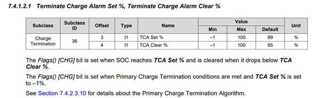

bqStudio>>Registers>>BIT Registers>>CHG充电的时候不跳变是哪里引起的,充电电流完全是符合设置的?这个值会影响学习测试吗,如果影响,影响哪方面?
您好,CHG是通过SOC控制,一直是low说明充电没有充饱。RSOC到不了100%,
This flag is controlled by SOC. Please check 5.4 in the TRM https://www.ti.com/lit/ug/sluubb0/sluubb0.pdf
Please also make sure that the gauge detected the battery (see 2.5.2 in the TRM)
