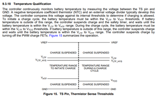

TS设置在3.3V的一半,如图R4156已经修改为9.31K

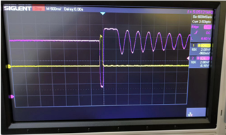

上电时STAT1指示灯亮,STAT2灭,PH和HIDRV的值几乎一致,充电时候 HIDRV,LODRV的波形如下:

    I am not understanding this part. If there is no thermistor used in this design, the TS pin voltage reading would be 3.23V which is not half of 3.3V and put the device in the charge suspend state based on the schematic. Is this the latest schematic they used for their design?
    STAT1 and STAT2 both off indicates Charge suspend, timer fault, overvoltage, sleep mode, battery absent and the waveform provided looks like the charge suspend waveform provided in the datasheet.
    There is a possibility that the charge timer expired due the the timer being set to 1hr (based on the schematic).
