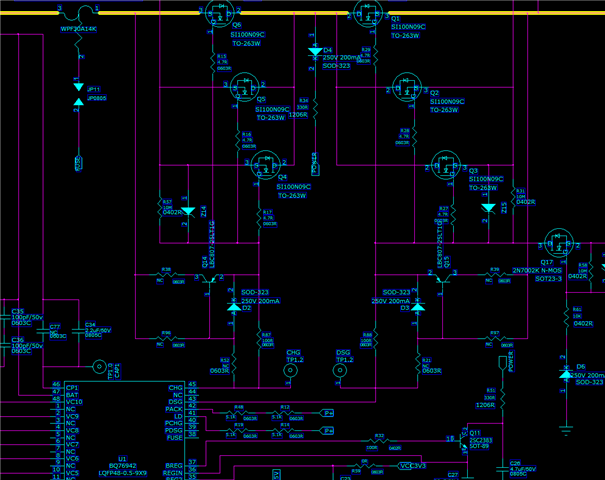

当产品进入过放保护后,通过MCU给Rst_shut引脚高电平使BQ76942进入shutdown,我们测试时发现放电MOS会重新开启再关闭,然后芯片才进入shutdown。请问这个是什么原因?
您好,Do you have an scope image showing the LOW-HIGH-LOW voltage on DSG pin? I tried recreating this on the EVM and what I could see was a slightly increase in voltage of 0.5 V before entering shutdown mode, but this will not cause DSG FET to turn ON.
您好,The PDSG pin is floating on the schematic, but is enabled on the settings. I would disable the PDSG_EN bit in FET Options register.

I recreated the testing procedure, and DSG FET will turn ON for approximately 750ms, then turn OFF. This happened when pulling up the RST_SHUTL pin. This happens regardless of CUV Delay time, so it is not depended to CUV Delay.
However, when sending the SHUTDOWN() subcommand, I did not see the DSG FET turning ON and OFF.
What it is happening here is that by pulling the RST_SHUTL pin high, the device does a partial reset before entering shutdown. The over-discharge protection flag will clear in partial reset causing the DSG FET to turn ON. Then, the device enters shutdown.
To avoid the partial reset, simply send SHUTDOWN() subcommand.
您好,工程师验证如下:
I tried on the bench the test with both CUV delays, and same result. I was able to recreate the DSG FET behavior with CUV = 74ms and 604ms. The CUV delay did not make a difference. This might be something to fix for future devices.
I suggest to use the SHUTDOWN() subcommand.
