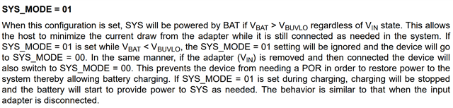

4.如果设置SYS_MODE = 01,电池充满电后;如果5V一直在,等电池电压掉下来后,后续是否还有recharge的阶段?

    4, 请参考下面的内容 :If SYS_MODE = 01 is set while VBAT < VBUVLO, the SYS_MODE = 01 setting will be ignored and the device will go to SYS_MODE = 00. In the same manner, if the adapter (VIN) is removed and then connected the device will also switch to SYS_MODE = 00.
