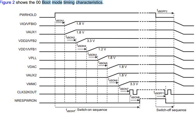

关于TPS65910A3和AM3352的上电时序!
Other Parts Discussed in Thread: AM3352
TPS65910A3只给出了00 Boot mode timing characteristics和01 Boot mode timing characteristics的上电时序图,没有给出EEPROM Boot mode timing characteristics的上电时序图。到底TPS65910A3的EEPROM上电时序是怎么样的呢?下图是00 Boot mode timing characteristics的上电时序。
