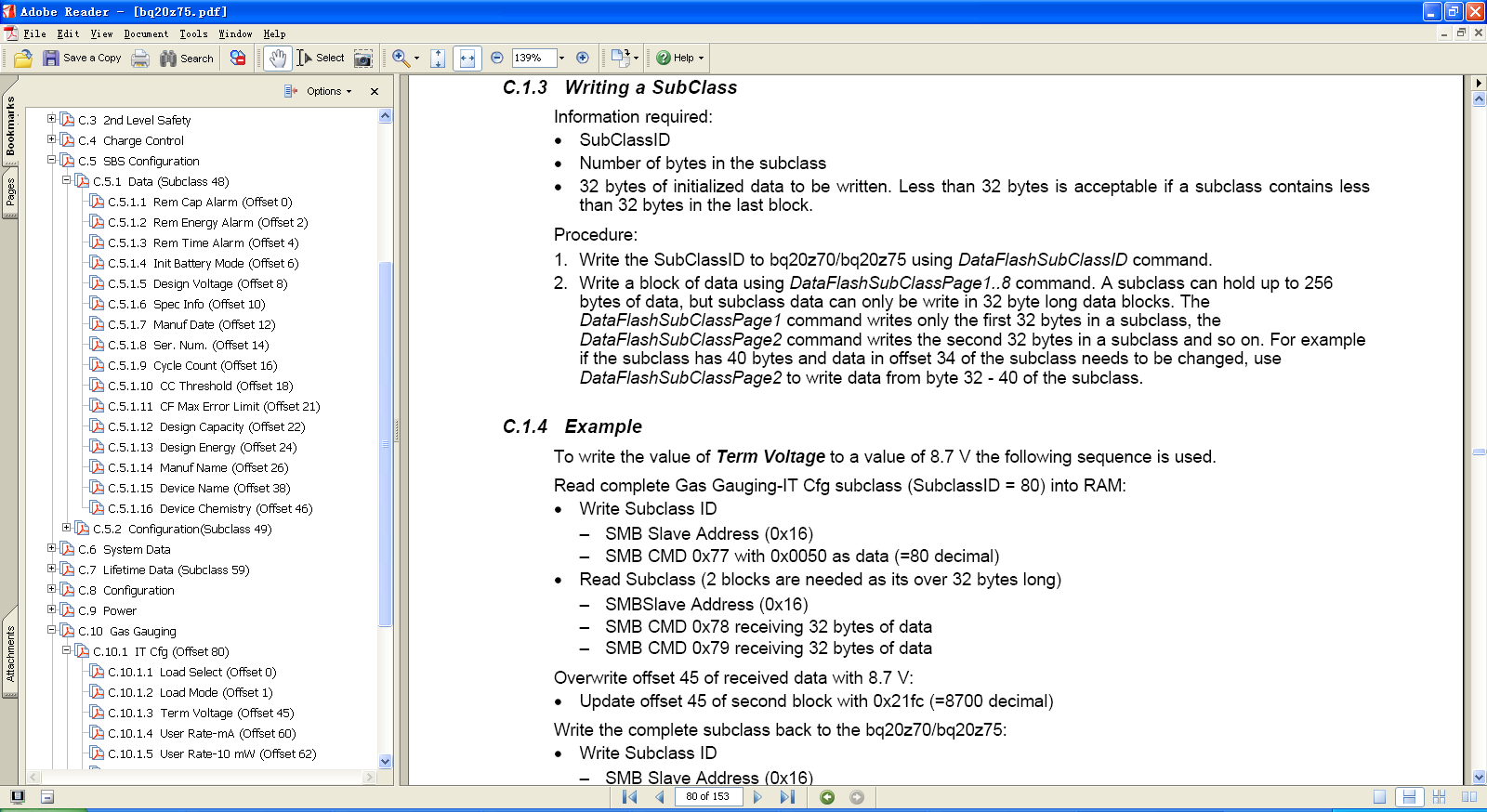

不知道是不是参照ti提供的这个example来读写dataflash!

Read required block of Gas Gauging-IT Cfg subclass (SubclassID = 80) into RAM:
· Write Subclass ID
– SMB Slave Address (0x17)
– SMB CMD 0x77 with 0x0050 as data (=80 decimal)
· Read Subclass (2nd block is needed as its offset 45)
– SMB Slave Address (0x16)
– SMB CMD 0x79 receiving 32 bytes of data
Overwrite offset (45 - 32 = 13) of received data with 8.7 V:
· Update offset 45 with 0x21fc (= 8700 decimal)
Write the updated block back to the bq20z70/bq20z75:
· Write Subclass ID
– SMB Slave Address (0x17) SMB CMD 0x77 with 0x0050 as data
· Write Subclass
– SMB CMD 0x79 with 32 bytes of data
针对block内某些字节的操作,你可以指定offset,比如DESIGN CAPACITY的class id是48,offset是22,那么CMD 0x77处写入0x30,选定block的CMD是0x78而不是0x79,因为offset 22小于32。
