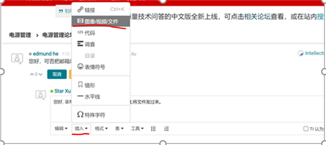

您好,请将 .gg file and the GPCCHEM report and data submitted发过来看一下。
