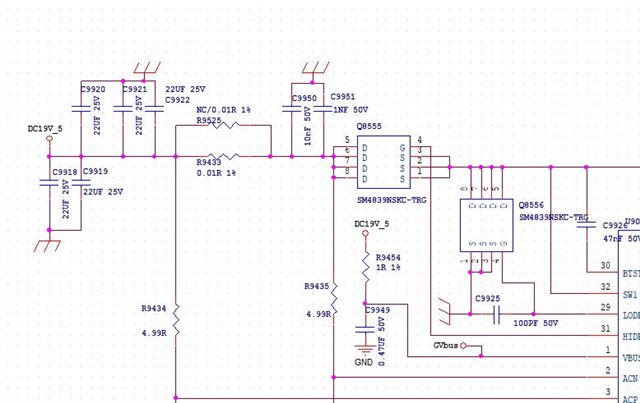

Adapter output rush current check,Irush:47.2A in 4us。please tell me how to cancel this current rush。
您好
This inrush current has nothing to do with BQ25713. It is purely the adapter first charges up the input capacitors. We have an inrush control ciruitry in the BQ25713EVM. See below. Suggest the customer enabling this circuitry.
