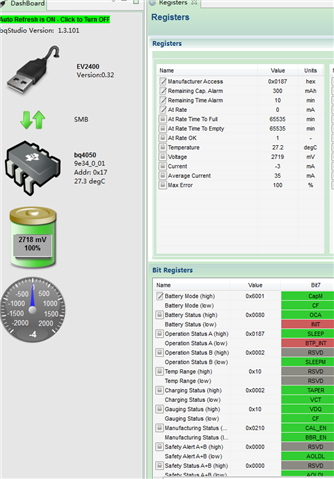

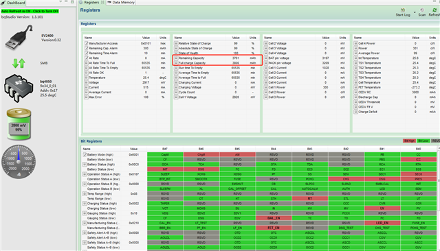

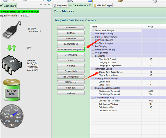

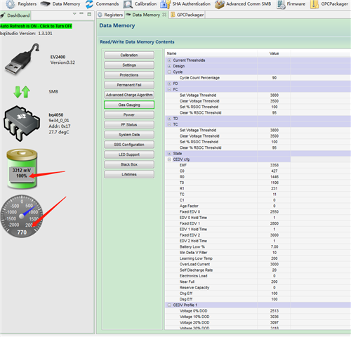

BQ4050充电时,dashBoard状态栏显示已经是100%电量,但充电电流还有772mA,是那里没有设置对?
CEDV cfg和CEVE Profile1是CEDV学习后,ti返回的report参数.
您好,我的电池是磷酸铁锂,标称电压为3200mV,充电电压为3650mV,电量为3800mA,充电结束电流为0.01C-3.65V。测试的板子为BQ4050EVM-561,即ti官方的彷真板。这是gg配置文件,请帮忙查看一下:2023-03-13-(1serise).gg.csv

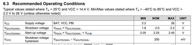

1,请参考数据手册6.3 Recommended Operating Conditions

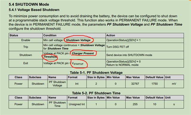

2,shutdown 状态下PACK的电压小于Charger Present Threshold
To wake up the device, a voltage > Charger Present Threshold must apply to the PACK pin. The device will power up and a full reset is applied.
