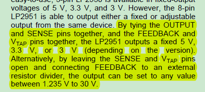

1、请问LP2951-33 除了固定电压3.3V输出以外,是否还能输出可调电压?
2、LP2951DR是不是只能输出可调电压,它与LP2951CMX/NOPB的区别是什么?

固定输出版本LP2951-30, LP2951-33, LP2951-50, 无需外部反馈电阻。电路可以参考datasheet第16页图33.
LP2951可调输出,通过反馈电阻设置输出电压。
TI e2e回复如下,供参考!
Yes when the sense and tap voltages are left floating the device is allowed to be externally programmable with a resistor divider.
“Alternatively, by leaving the SENSE and VTAP pins open and connecting FEEDBACK to an external resistor divider, the output can be set to any value between 1.235 V to 30 V”
The LP2951DR and the LP2951CMX/NOPB are functionally devices that serve identical purposes. The two devices do have different datasheets detailing their testing conditions and exact specifications, but they are jellybean components that were designed by TI and National semiconductor respectively. TI acquired National Semi but kept producing this part for legacy purposes
