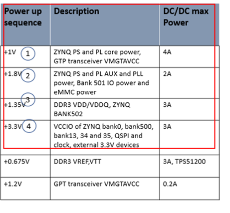

        TI有没有ZYNQ7000-电源方案?如下输入是5V4buck power的集成的解决方案,或者分离DC-DC,高性价比的,交期好的,最好是工控行业客户批量使用的方案,请提供推荐型号,谢谢!
Hello!
Does TI have ZYNQ7000- power supply solution? The following input is an integrated solution of 5V four-way buck power, or separate DC-DC, which is cost-effective and has good delivery time.
It is better for industrial control industry customers to use in batches.
Please provide the recommended part number to me, thank you!
