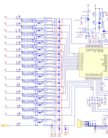

schematic:

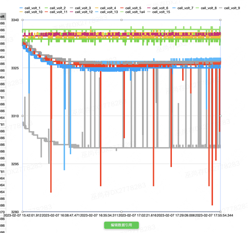

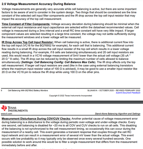

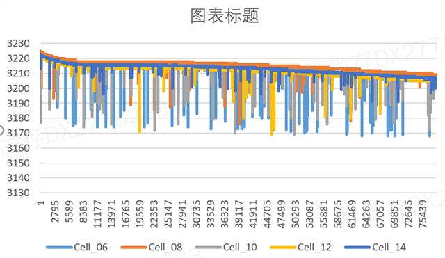

By configuring the software to open odd or even cell balancing, it has an impact on the sampling error of other sections (see the figure below for detailed data), and not only on cell15. Therefore, during balancing, the sampling accuracy cannot be compensated only for cell15 (n * 35 uA* 100Ω/1000=3.5(mV) * n). What is the reason for the impact on the sampling accuracy of other cells? Is it inconsistent with the description in the specification? How to avoid the impact of sampling errors on other cells?
1,To open odd cell balancing,and then cell5、cell7、cell9、cell11、cell13、cell15 sampling accuracy is affected.
2,To open even cell balancing,and then cell6、cell8、cell10、cell12、cell14 sampling accuracy is affected.
