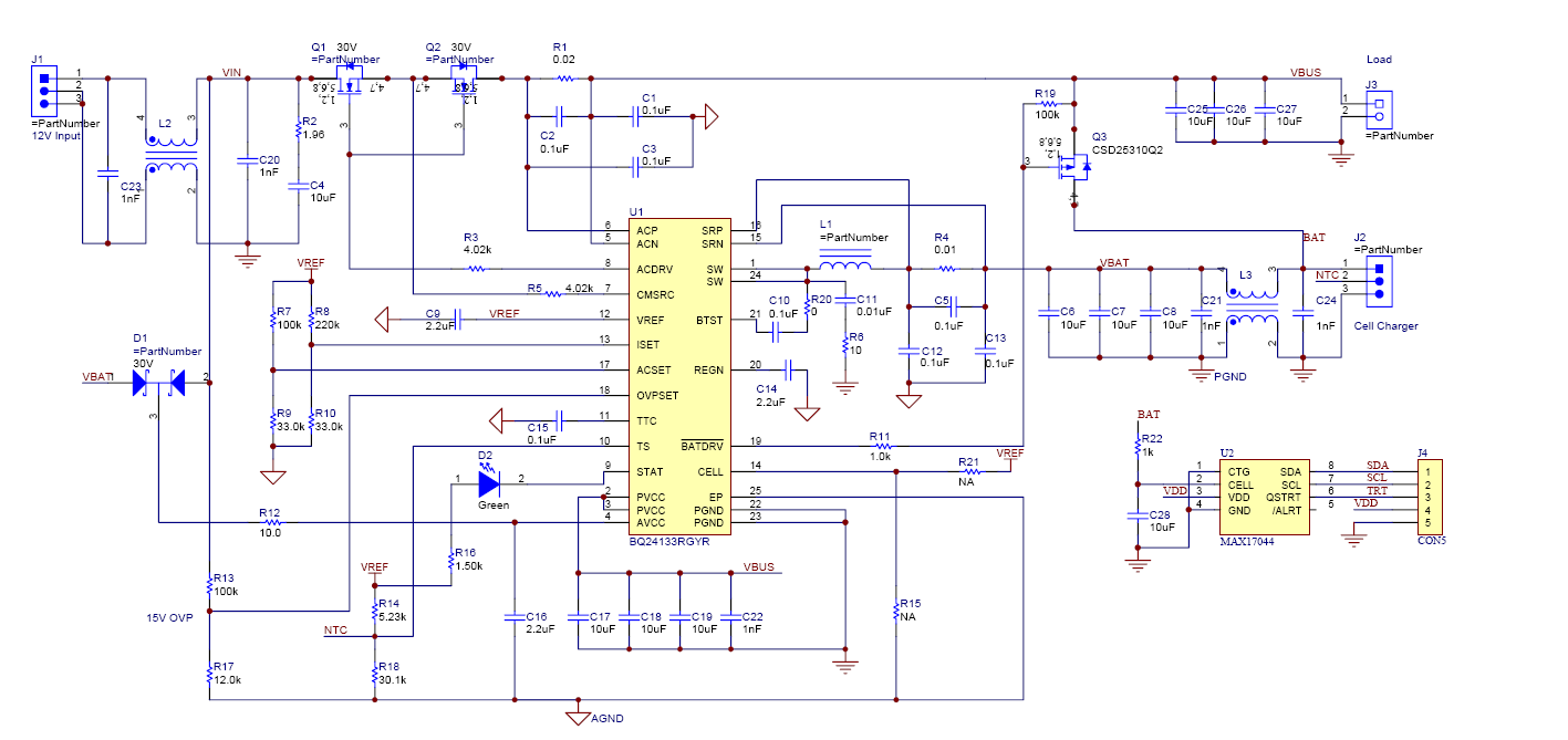

Other Parts Discussed in Thread: BQ24133
引脚 |
电压(V) |
SW |
0.39 (不正常) |
PVCC |
13 |
AVCC |
12.78 |
ACN |
13.03 |
ACP |
13.03 |
CMSRC |
12.70 |
ACDRV |
18.24 |
STAT |
2.3 |
TS |
1.69 |
TTC |
0.57 |
VREF |
3.89(不正常) |
ISET |
0.28 |
CELL |
3.89 |
SRN |
0.40 |
SRP |
0.40 |
ACSET |
0.46 |
OVPSET |
1.43 |
BATDRV |
13.03 |
REGN |
0.03 |
BTST |
0.34 |
PGND |
0 |
AGND |
0 |
充电指示灯不亮 几个引脚电压不正常下面附件是电路原理图麻烦TI工程师看看什么原因
