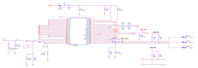

您好,
為何BQ76952 REG1V8 引腳上的電壓在與MCU通訊後會被拉到3.3V
線路架構在 CFETOFF, DFETOFF, 有一外部上拉電阻到3.3V
Settings:Configuration:CFETOFF Pin Config 設置為 AA
电路如貼圖

您好,
REG18 指示外接一顆2.2uF電容, 沒有接到其他地方,
GG文件 設定如下 :

您好,请参考下面内容:
I've tested these settings and found that you are using SPI comm mode here but the CFETOFF pin is configured as Bits1:0 [ 1 0 = CFETOFF mode] . For the CFETOFF pin to be properly configured for SPI mode you need to set Bits1:0 to [ 0 0 = SPI_CS ] in the CFETOFF pin config. This should then have REG18 outputting 1.8V normally (writing 0xA8 to CFETOFF Pin Config register should do the trick).
您好,请参考下面内容
SPI Configuration register was set to 0x60 and thought this was being used in SPI mode.
We did manage to recreate what you are seeing and we recommend that you disable OPT1 (bit 3) in the DFETOFF/CFETOFF Pin config as this should fix the issue.
