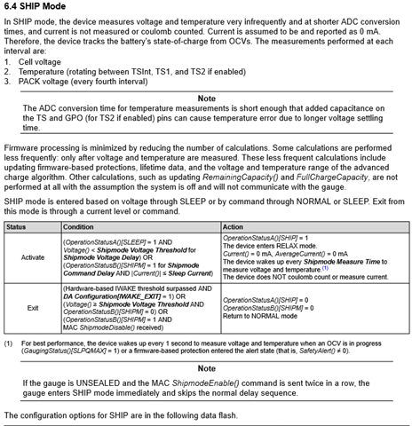

1、芯片通过命令进入SHIP模式后,再进行充电或放电操作,bqstudio的表盘上是否应该有电流显示?
2、进入ship 模式后,如何退出此模式?
您好,This is working as intended, SHIP mode will only be released when either IWAKE is tripped, Voltage >= Shipmode Voltage Threshold and SHIPM = 0, or SHIPM=1 and MAC Shipmode Disable command is receieved. IWAKE will only trip on discharge current, not charging current.

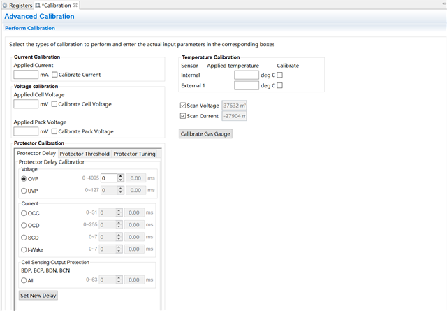

您好,How are you setting IWAKE? If you set it in the data memory tab it will not work as this does not actually change the protection trim. It must be set in the calibration tab in either protection threshold or protection tuning. If 300mA is the target then IWAKE should be set to -0.3 mV.
