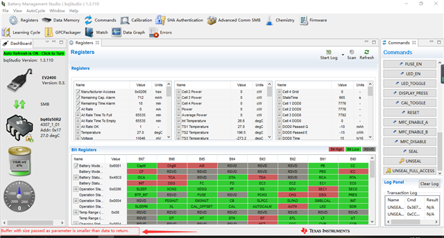

如图,调试芯片时,BQS提示如下错误“ Buffer with size passed as parameter is smaller than data to return”, BQS版本1.3.110;
请问这个问题产生的可能原因,如何解决,谢谢!
您好,
Try using a newer version of bqStudio. I would recommend renaming/deleting the old install folder before installing the new version.
