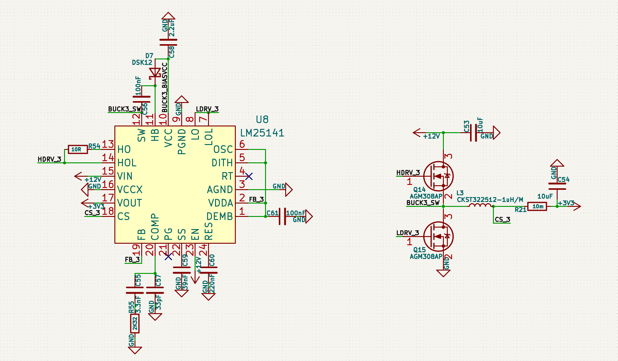

I'm designing a Buck converter with LM25141, with 12v input and 3.3v output.
Following Webench designer and datasheet, I tied FB pin with Internal LDO output.
But it's outputing 1.5~1.6v now, and I soldered 3 PCBs in total and two of them got 1.5~1.6v, the third one got.. 3.23v, after I unplugged and re-plugged the input voltage in, it's dropping!
From 3.23v, to 3.13v during the second time... and 3.09v the third time... and 2.90v at last
THATS WEIRD! and here's my schematic

I just chose the model of the inductor and MOFETs according to the limit value it recommends, and the other parts have not been changed.

首先带电插拔是有问题的,容易造成输入电压震荡而过压损坏。只是这款芯片输入电压高达45V, 不应该会损坏芯片。
建议你确认一下功率电感质量,特别注意饱和电流足够。
但是我上电的时候其实是空载状态,理论上电感不会饱和的才对.. 这个电感的饱和电流至少大于5A
