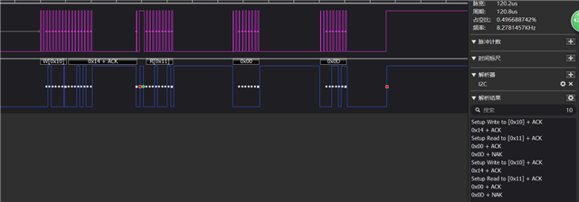

BQ76952 请问这个AFE芯片有没有需要唤醒的管脚,如何判断芯片已经工作,I2C 的时序,能介绍下吗,发送I2C 从机地址,寄存器地址,需要重新I2C 总线后再发送 读地址命令吗?
您好,请参考下面内容
I need more details on what we are trying to achieve here. I assume there's issues communicating with the device. What is being written here? Are you trying to read cell-1 voltage?

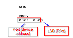

I would like to mention that the device address is 0x08 written as 7-bit. It is 0x10 with the LSB for R/W (see below).
The BQ769x2 Software Development Guide explains the sequence to write and read to different memory locations (RAM, etc). It also shows I2C waveform captures.
