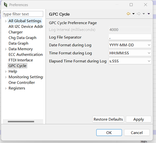

我在利用BQSTUDIO采集电池模型时,想设定GPC CYCLE的扫描时间间隔为5秒。而BQSTUDIO的preferences中GPC CYCLE下的时间间隔的设定为什么是灰色的?我该如何设置?
您好,非常抱歉,log interval 修改log时间已经取消,不能修改。
I assume this is for debug purpose, many times we only need to spot check some points, not the full datalog. If you really do, you may use HOST or develop your own "host" by using MSP430, which is not super difficult.
