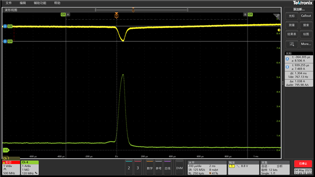

TPS1H100BQPWPRQ1   is currently using an rush current of around 5A
According to the specification calculation, the resistance value of Rcl is set at 540 ohms;
The current limit is exactly 5A, and the voltage drops by 1V, but at low temperatures it drops by 3V; we can accept a maximum drop of around 1V;
The actual rush current may beyound 6A,so we plan set Rcl at 270Ω OR 0Ω;
question:
1 The resistance value of Rcl is set at 0  ohms, use  internal current limit  and is there any mass production in use;
2. Is there a solution to the impact current at low temperature that causes the output voltage to drop;
