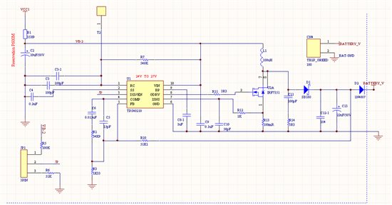

I have some question to design the IC tps40210
Other Parts Discussed in Thread: TPS40210, BQ24620
I use the “SwitcherPro Desktop”software to design .
My  Vin=23~25  Vout=27V  IOUT=0.1A
I have  different  resistance from 105 mR  to  100mR (R13)
MY  Loads  is  double  12v’s  battery.

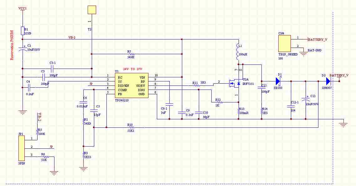

My  circuit  as  below
My  Vout  will  connet to  24v  battery to support battery electrify.

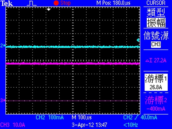

When I no connect the battery (NO LOAD).
My  Vin  is  24V , Vout  is   27v ( red wire),Iout is 0A(blue wire) .  as below .
It’s OK.

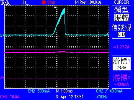

But when I connect the battery . (Connect LOAD)

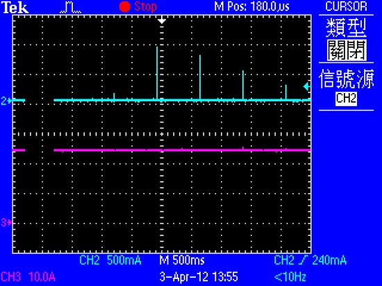

My  Vout  from 27 down to 24.4v and the IOUT (OUT CURRENT) have a 1.1A, 1.16ms.
The  current ‘s  distance about 700mS
As below two photo.
I want to know what’s happen?
How  can I  let  my  circuit  Vout=27v Iout=0.1A when I connect the load?
