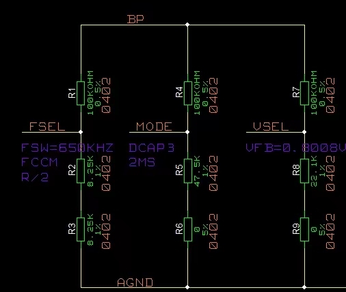

TPS549D22替代TPS548D22,只修改FSEL阻值,PIN 32脚的R2,R3换位0欧盟,其余外围不变,输出会收到影响吗
1.The TPS549D22 defaults to 650kHz switching frequency with the 1xR ramp generator and only allows this to be adjusted via PMBus.
如果是1/2R,需要通过PMBUS吗?还是默认650Khz?
如果原来PCB没有预留PMB_DATA ,PMB_CLK,是不是不能替代?
2.TPS548D22 designs which selected lower switching frequencies than 650kHz may suffer from increased switching losses and thermal stress.
In designs which were previously tested with a lower switching frequency, power dissipation in the snubber resistor (Series R-C to from SW to GND) should be double checked at the new, higher switching frequency.
是不是SW的频率低于设定值是正常现象?
