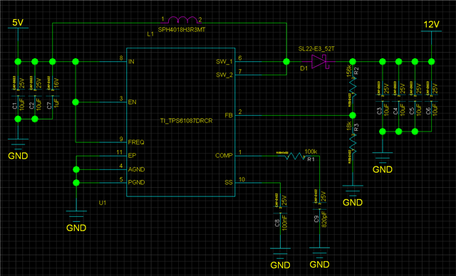

TPS61087: When the output current increases slightly from 5V to 12V, the output voltage will decrease and cannot reach the 900mA output current described in the data manual
Part Number: TPS61087

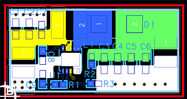

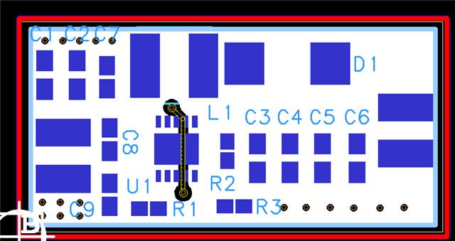

  • The schematic diagram and PCB are shown below
  • TOP  LAYOUT
  • BOT LAYOUT
  • The schematic is based on the circuit recommended by the data manual. Do you know why?
  • Hi
        电路借助芯片官网的在线仿真webench仿真获得(或者参考datasheet中推荐电路),主要注意功率电感饱和电流足够,输入电容尽量靠近芯片Vin脚和电感输入端,功率回路尽量小(layout可以尽量参考datasheet 第23页), 上述都可能导致带载能力下降。
