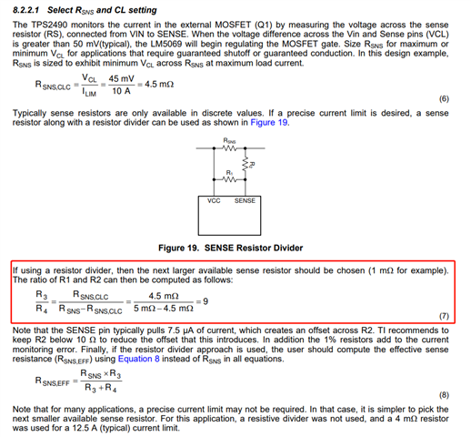

Here R3 and R4 should be R1 and R2, right? Should the formula of R1 and R2 be i=45mv/(Rsns*(R1/(R1+R2)))
