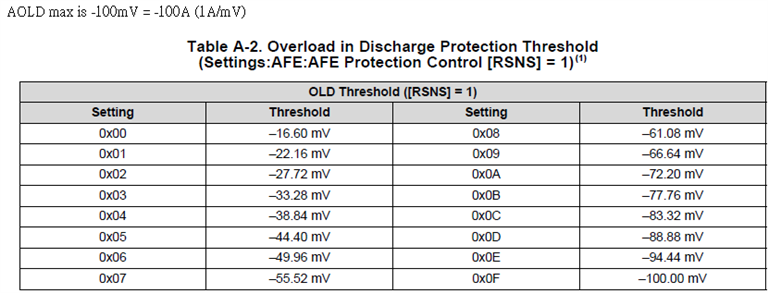

Now we always trigger AOLD protection.
Because our new product "Peak Current" has a high chance to over -100A
Hi,

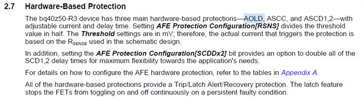

100mV is the max the gauge can be set to for this protection, you would have to use a lower sense resistor in order to support applications with over 100A discharges.
Thanks
Hi,

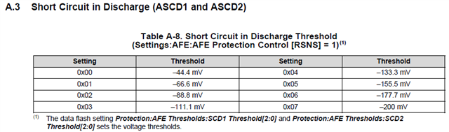

The ASCD hardware overcurrent protections occur faster than the overload (AOLD). The gauge cannot support continuous currents over 100mV (100A with 1mOhm sense resistor) because AOLD maximum setting is 100mV.
