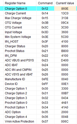

Hi  ti team,

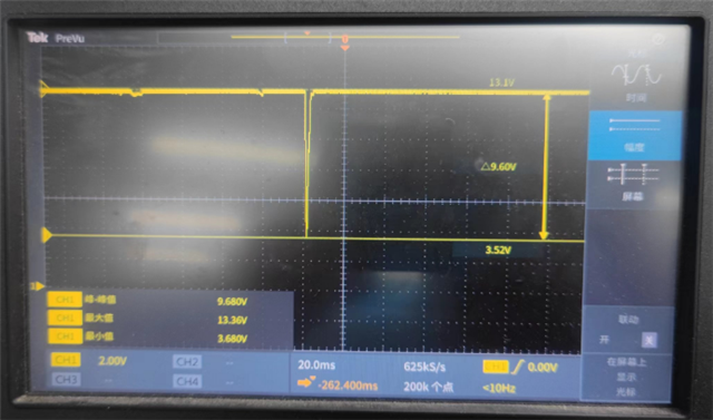

在BQ25720 插入适配器时,Vbat电压会从会13.5V掉到3.5V造成系统掉电,请问这是否正常?
Vbat:
寄存器配置:
  • 您好,It looks there is no battery on the battery terminal, otherwise, the battery voltage will hold at 13.5V. When the system voltage dips below 3.25V, system will restart.
    Could you monitor the adatper voltage, system voltage and battery voltage in the same plot?
