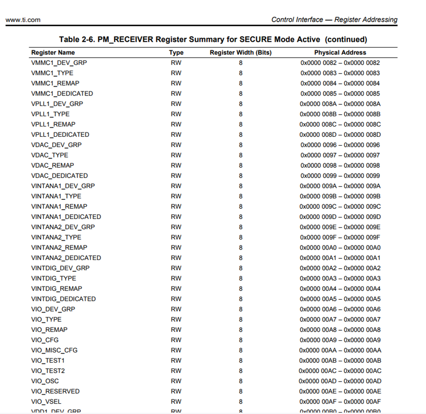

Failed to set the register address and data bits of 40H, 41H, and 42H in the datasheet.
3.What we have already done

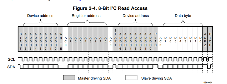

We read and write IIC data according to ID4 (0x4B) on the TPS65930 instruction manual, corresponding to the Read, Write addresses of IIC 0x97, 0x96). (P72-P81)
Failed to read VMMC2_DEV_GRP correctly (tried both types of data)
The read VMMC2_DEV_GRP instruction is: 96H 82H 97H.
The read VMMC2_DEV_GRP instruction is: 96H 27H 97H.
Note: (VMMC1_REMAP Address Offset is ·0x27, VMMC1_REMAP Address 0x0000 0082-0x0000 0082, we understand Register Adress as 82H)
I don't know what the problem is, can you guide the correct reading of the instruction data is how much it is? Thank you.
