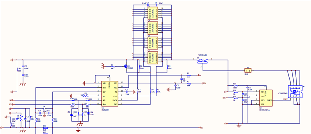

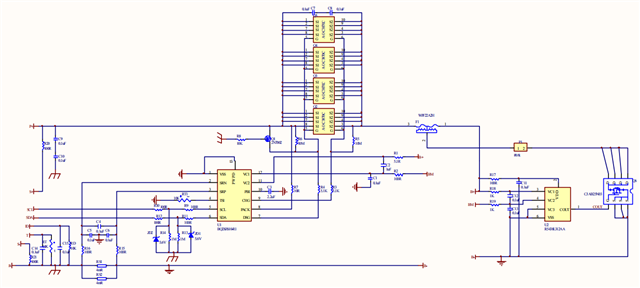

关于BQ28Z610-R1短路烧MOS问题,怎么解决?
1,电芯容量11000mAh,总电压8.9V
2.MOS型号:AOC3870C*4
您好 ,请参考下面内容
There could be many causes of electronics failures, but for a short circuit in a battery the following are some possible causes to consider and test:
Please reference to this FAQ for SCD debugging. How to debug FET failure resulting from short-circuit testing
I am inclined to say this behavior is due to bullet point number 4 above. The gate of each FET requires a small gate resistance to avoid oscillations. Please also reference to this app note - Tips for Successfully Paralleling Power MOSFETs
