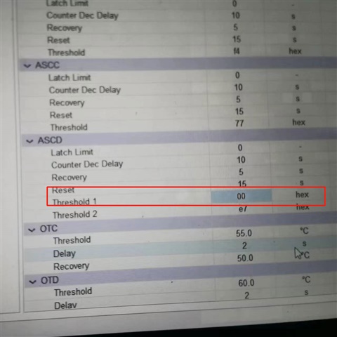

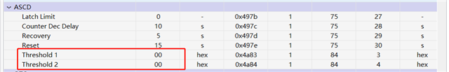

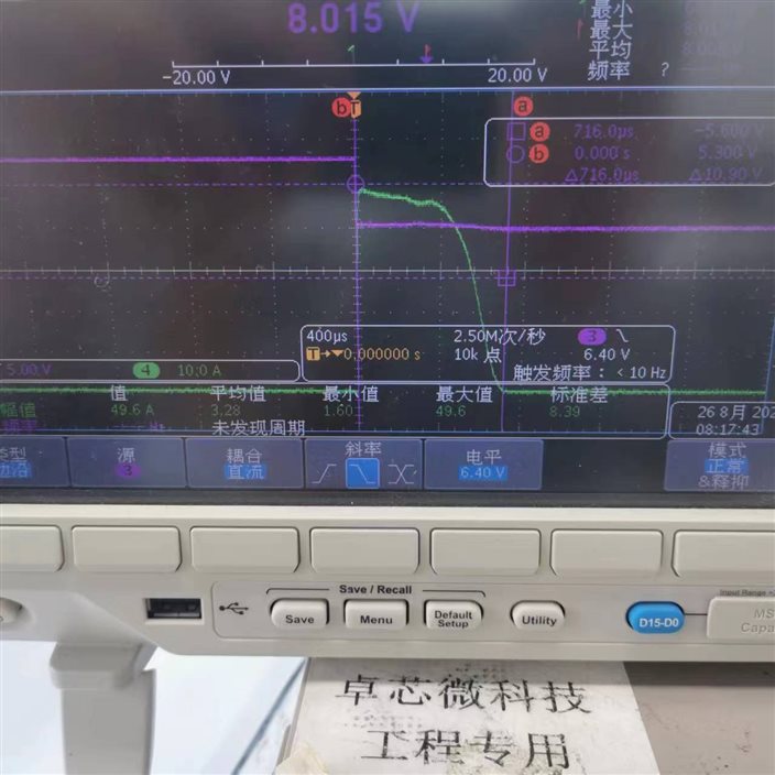

需要调整额Rsense 电阻吗?
另外这个时间 需要怎么修改 才能缩短,
目前示波器 抓出来 电流是 50A 左右 时间为 760uS 设置参数如上
感谢!

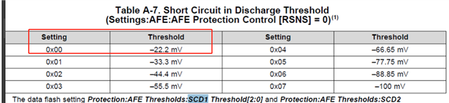

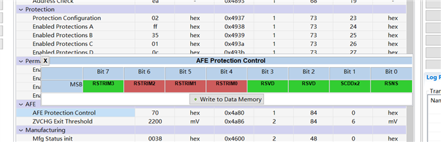

您好,The hardware protections use preset comparator voltage thresholds on the current sense pins, SRN and SRP, to determine a fault. It should be noted that the value programmed according the AFE Threshold and Delay settings will have the tDETECT time added, which should be accounted for when setting the hardware thresholds, especially the Short Circuit in Discharge (SCD) delays.
Please see this FAQ for examples.
