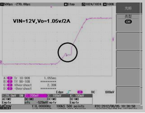

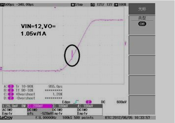

When test TPS54229 EVM found there is big spike or ripple voltage during startup, but there is no similar issue refer to TPS54229 EVM user guide, would you help clarify the reason and help solve the issue?

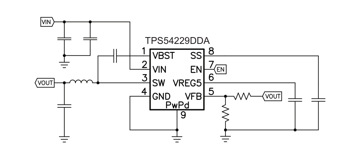

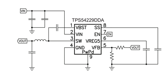

Typical Application Circuit as shown below:

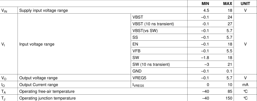

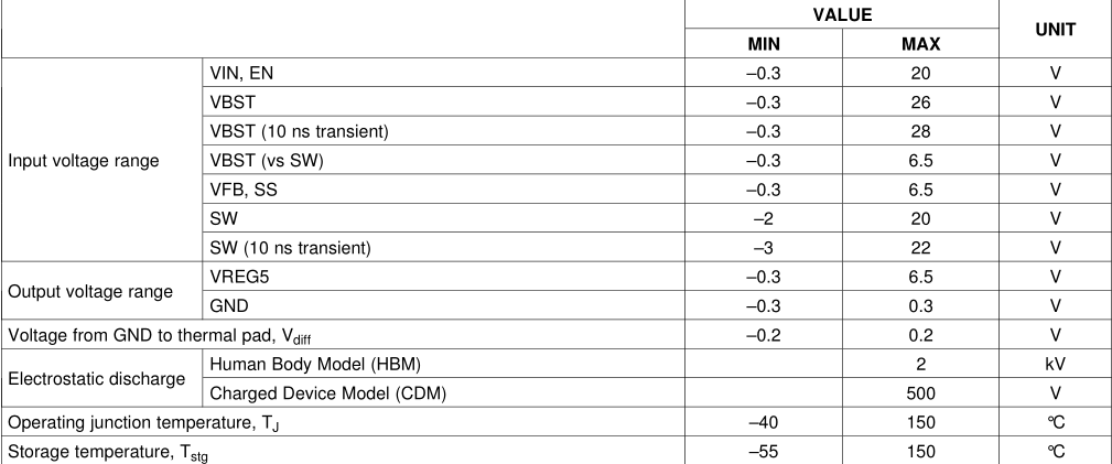

Absolute maximum rayings as shown below:
Recommended operating conditions as shown below:

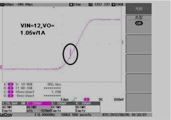

Author simulation waveforms as shown below:

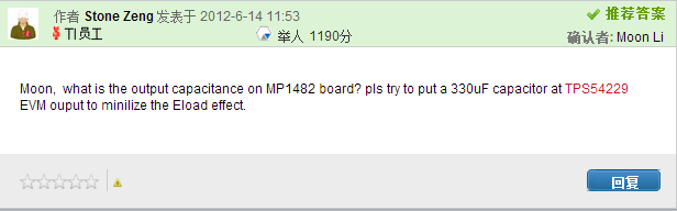

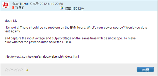

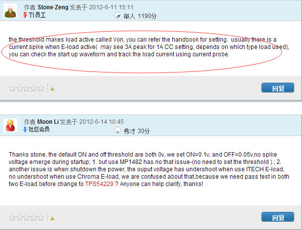

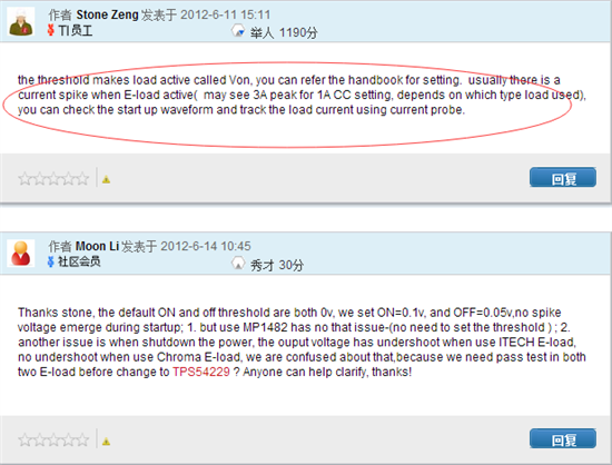

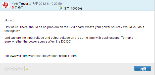

about this ,the TI FAE answers:
As can be seen from their answers,we can learn about the chip of TPS54229,I encountered such a problem for the future, providing answers to the idea, but also increase their experience.thanks very much.
