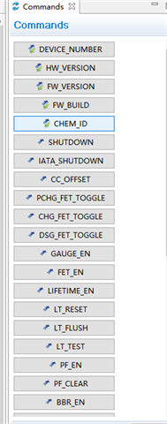

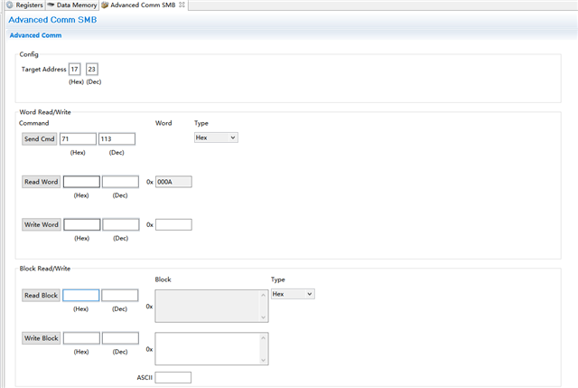

  请问这两者发送命令的区别是什么,都是使用I2C发送命令,为什么左侧的不能发送COMMANDS的内容,或者说使用I2C发送这两者命令之间的区别是什么
  • 您好,The commands buttons are additional commands that are available in BQ40Z50
    ManufacturerAccess is an SBS command that is read/write. The behavior is defined by TI(manufacturer) and detailed in the TRM.
    commands 命令有限, Use the advanced comm SMB for commands that do not have a button or register display.
