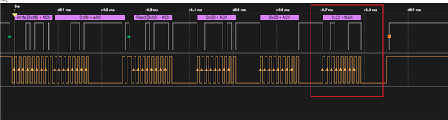

使用逻辑分析仪抓取的波形

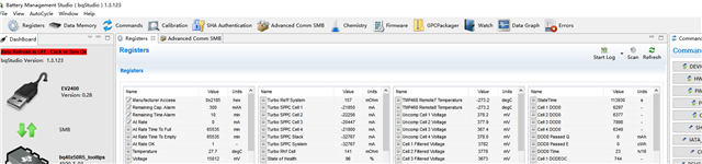

请问最后的数据是什么,发送不同的命令有不同的值
您好, Is auto-refresh disabled during your testing? If it is not then it will cause the same behavior as you have shown in the screenshots since it is constantly using MAC commands to pull data the gauge will return the last MAC command data from the auto-refresh.
您好,已经在E2E英文论坛发帖,暂时没有收到回复,请继续关注该帖。
