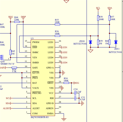

关于BQ78350-R1,其通信协议是ubus(对应的引脚是SMBD,SMBC).但是我看到有些用法,将SMBD和SMBC分别连接到SCD,SDA,当作I2C,这种用法是否可以。需要注意什么?

Please follow the examples in the simplified schematic and the EVM, the communication buses on the BQ78350 are not tied together, one is specifically for communicating with the monitor AFE.
