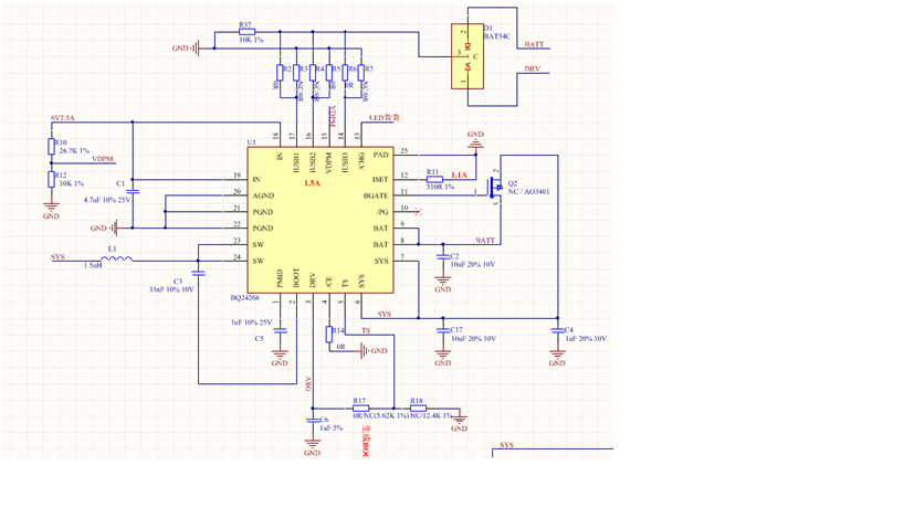

正常工作时:                                         异常工作时:
输入电压:6.03V                                  5.97V(外接的电源电压)
输入电流:1.4A                                    87mA
V - DPM = 1.64V                                   1.62V
V - Iset   =  1.15V                                   0V
V - BGATE = 3.95V                               4.26V
V - BAT = 3.85V                                    4.12V
V - SYS = 3.97V                                    4.26V
V - SW = 4.01V                                     4.27V
V - PMID = 5.96V                                  5.93V
V-  BOOT = 8.49V                                 7.91V
V - DRV = 4.86V                                   4.1V
V - TS = 4.86V                                       4.1V
V - chg‘ = 0.01V (接地)                    2.4V(Hi-Z)
