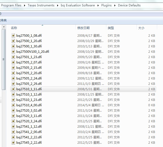

HI all,
        由于不慎烧错了DFI,如附件所示。
        默认的密码,Sealed to Unsealed This is the register to store the security code to set the device from sealed mode to unsealed mode. Normal Setting: The default code is set to 0x36720414. Unsealed to Full This is the register to store the security code to set the device from unsealed mode to full access mode. Normal Setting: The default code is set to 0xFFFFFFFF.
      0x36720414和0xFFFFFFFF都打不开流量计了。
      TI文档中有FactRestore Key This is the register to store the factory restore key to allow forcing a factory restore of learned resistance and Qmax to defaults if the device is sealed. Normal Setting: The default code is set to 0x0DEF0FAC
        类似的出厂复位,但是找不到解密码啊!
        贵司最原始的密码是哪些啊!?
        急求,谢谢!!
       请协助解决!谢谢!
