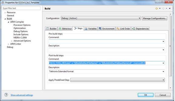

RT,自己在CCS5.4环境下重新新建工程,将旧工程文件(CCS3.3)相关文件迁移到新建的项目工程文件中,编译有通过,但是生成“.out”文件,并没有期望的“.x0”。
已经查阅过《Converting UCD3138 F/w Project from CCS version 3.3 to 5.2》,并不能解决我碰到的问题。还是说需要在哪里要做其他特殊设置??
请求帮助,谢谢~~

'Create flash image: TI-TXT'
"C:/ti/ccsv5/tools/compiler/arm_5.0.4/bin/armhex" --ti_txt "ProjectTST2.out" -o "ProjectTST2.txt" -order MS -romwidth 16
Translating to TI-TXT format...
"ProjectTST2.out" ==> .vectors
"ProjectTST2.out" ==> .text
"ProjectTST2.out" ==> .const
"ProjectTST2.out" ==> .cinit
"ProjectTST2.out" ==> FixedDeviceID
"ProjectTST2.out" ==> .CONFIG
