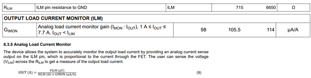

TPS2597: 如何采集TPS259472A的ILM电压用于电流监测
Part Number: TPS2597
TPS259472ARPW手册中介绍:通过测量ILM管腿的电压可以换算成ADC进行采样的电流值,请问该PIN的电压摆幅为多少
配置情况如下:
PARAMETER
VALUE
Input supply voltage (VIN)
12 V
Undervoltage threshold (VIN(UV))
10.8 V
Overvoltage threshold (VIN(OV))
13.8 V
Output power good threshold (VPG)
11.4 V
Max continuous current
5.5 A
Load transient blanking interval (tITIMER)
2 ms
Output capacitance (COUT)
470 μF
Output rise time (tR)
20 ms
Overcurrent threshold (ILIM)
6 A
