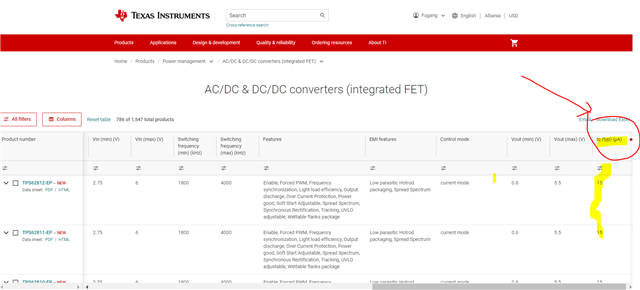

关于你的咨询,TPS60401 芯片目录中有Iq的筛选项目,你排序下。
https://www.ti.com/power-management/acdc-dcdc-converters/products.html#236typ=0.06%3B100&
