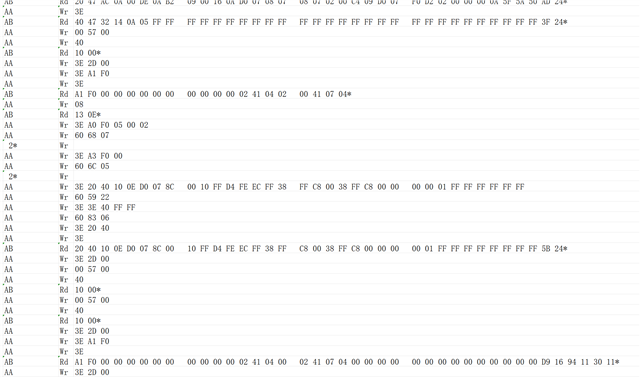

BQ27Z746: Protector Threshold中,进行OVP校准,DataSheet中没有对应的校准流程,通过monitor抓取后不知道其意思,是否有这些详细说明?
Part Number: BQ27Z746
    通过monitor抓取到BQ软件校准OCP Threshold时的指令,如下表所示,不知其具体信息,是否可以说明下0xF0A0 后面的数据是怎么获取的,以及最后一步读取0xF0A1的数据长度为什么不是32位或者34位
AA Wr 00 57 00
AA Wr 40
AB Rd 10 00*
AA Wr 3E 2D 00
AA Wr 3E A1 F0
AA Wr 3E
AB Rd A1 F0 00 00 00 00 00 00   00 00 00 00 02 41 04 02   00 41 07 04*
AA Wr 08
AB Rd 13 0E*
AA Wr 3E A0 F0 05 00 02
AA Wr 60 68 07
 2* Wr
AA Wr 3E A3 F0 00
AA Wr 60 6C 05
 2* Wr
AA Wr 3E 20 40 10 0E D0 07 8C   00 10 FF D4 FE EC FF 38   FF C8 00 38 FF C8 00 00   00 00 01 FF FF FF FF FF FF
AA Wr 60 59 22
AA Wr 3E 3E 40 FF FF
AA Wr 60 83 06
AA Wr 3E 20 40
AA Wr 3E
AB Rd 20 40 10 0E D0 07 8C 00   10 FF D4 FE EC FF 38 FF   C8 00 38 FF C8 00 00 00   00 01 FF FF FF FF FF FF FF FF 5B 24*
AA Wr 3E 2D 00
AA Wr 00 57 00
AA Wr 40
AB Rd 10 00*
AA Wr 00 57 00
AA Wr 40
AB Rd 10 00*
AA Wr 3E 2D 00
AA Wr 3E A1 F0
AA Wr 3E
AB Rd A1 F0 00 00 00 00 00 00   00 00 00 00 02 41 04 00   02 41 07 04 00 00 00 00   00 00 00 00 00 00 00 00 00 00 D9 16 94 11 30 11*
AA Wr 3E 2D 00
