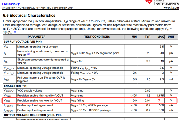

LM63635-Q1: What is the maximum value of VEN-L
Part Number: LM63635-Q1
Hi,
Could you please provide the maximum value of LM63635-Q1 VEN-L? I need this data for WCA calculation.
  • 为了确保EN功能良好,不建议在Ven_L~Ven_H范围内使用。我们没有Ven_L最大值,因为不建议将状态设置为Ven_L<Ven<Ven_H。
