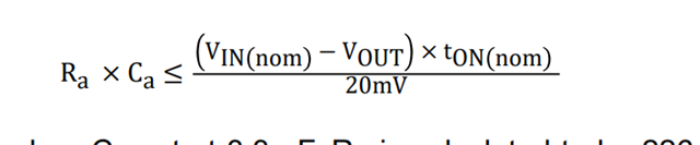

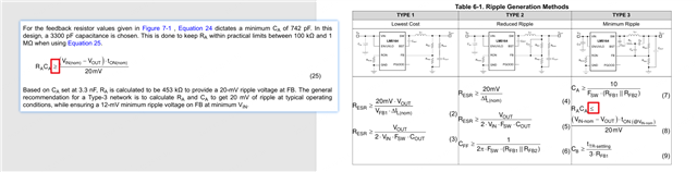

LM5164: Datasheet error,the content is contradictory.Which one is correct?The left?
Part Number: LM5164
