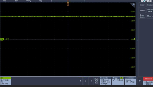

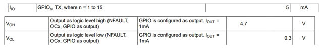

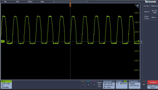

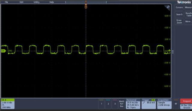

Dear sir:
We finded that current drive capabiity of BQ79731'GPIOS is less than 5mA, and can't drive A LED (IF=5mA, Vf=1.25V) when GPIO is output/Pu high. For example,GPIO1\GPIO2 OR GPIO4
Ref to follow pic:
