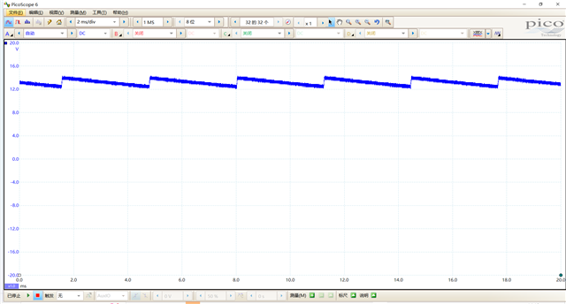

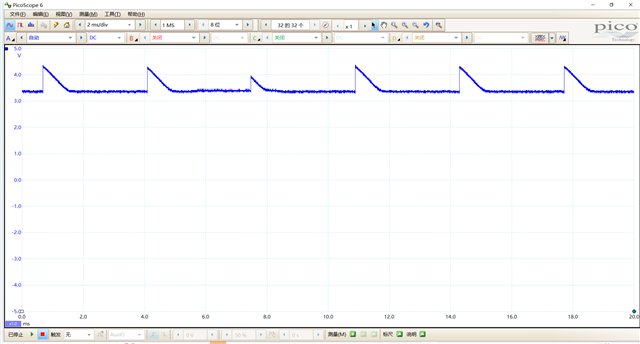

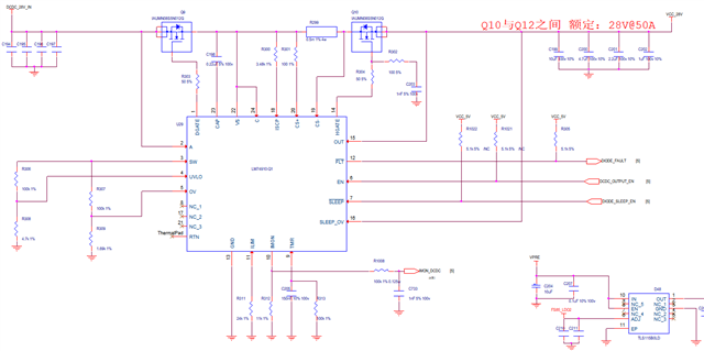

I use a LM74910 for my board, and the principle is as shown in the figure. The input voltage is connected to the A pin and the voltage is 28V. Now when I give EN and SLEEP high levels, DGATE is only 3.5V higher than A's level (9.5~14V is recommend in the manual); And HGATE is normal, 12V higher than OUT. VCAP capacitors also have a 12V dropout across the two sides, it means that Vcap to VS is 12V.
Later, I grounded ILIM and TMR and left IMON and ISCP floating, turned off the diagnostic function, changed the resistance of the NMOS gate to 0, and changed the VCAP capacitance from 100nF to 220nF, 320nF, 670nF, 1uF and so on (the Ciss of two MOS is 10^4 pF). DGATE to A is still 3.5V. Is it normal for DGATE to A to only 3.5V. Then I removed the resistor of the NMOS gate and DGATE to A became 12V. I keep changing the capacitance value of the VCAP and the series resistance of the NMOS gate, no matter how I change it, as long as there is NMOS, then the DGATE to A is about 3.5V.
Senior engineers, can you please help me analyze why DGATE to A can't be in the range of 9~14V as described in the manual?
