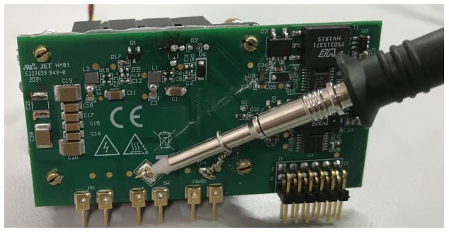

Is the evaluation board LMG3522EVM-042 suitable for double pulse test?
  • The evaluation board LMG3522EVM-042 can be used for double pulse test with probing of bottom side Vds waveforms using a high bandwidth passive probe as shown in figure.
    Unfortunately, the board does not have provision for device switching current measurement. For providing the PWMs and other power components, the LMG342X-BB-EVM motherboard can be used. Additionally by altering the switching node connection, hard-switched conditions can be created for both Top and Bottom side switch.
