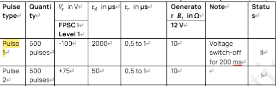

用在12V系统TI LM74810原理图外发审查.pdf域控上面,帮审查一下原理图是否有问题
1. Please keep the thermal pad floating.
2.Customer is using 40V rated FETs. We would recommend using 2 unidirectional TVS in back-to-back configuration as shown below.
For more understanding on TVS selection while using 40V rated FETs, please refer to section ‘10.2 TVS Selection for 12-V Battery Systems’ of LM74810-Q1 Datasheet
Pulse2 is a low energy pulse and will be suppressed by input and output caps only.
