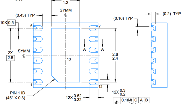

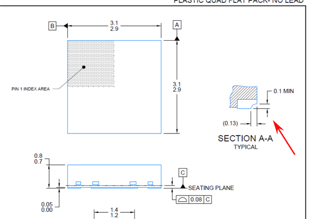

 LM74810手册上没有说封装是Wettable Flank-plated QFN Packaging,但是看封装图确像是,麻烦确认下
